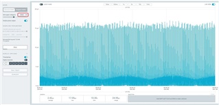

    If you want, you may try my project attached below to see if you see the same discrepancy. With this project I measure around 2.5 uA in both cases (full RAM retention).  The project was  based on the existing /peripheral/rtc example in nRF5 SDK v17.1.0.
    PPK2 plot
    Note: the supply voltage was set to match VDD on the nRF52 DK board to reduce leakage current.
