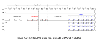

    Thanks for sharing the datasheet for your sensor. Looking at the description of the QUAD OUTPUT FAST READ - 6Bh operation, as an example, it looks like it should be compatible with the nRF device when using the READ4O operation:
    Diagram from the nRF52840 PS for comparison:

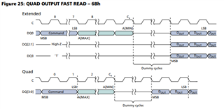

    When you say the command should be sent over 4 lines, you really mean that the first 8 byte command should be sent on all data lines?
    Looking at the Micron datasheet it doesn't look like this is the case. After all, until the command is read the device wouldn't know whether to use 1, 2 or 4 data lines.
    Best regards
    Torbjørn
  • I did look at the Interface Description, but what I originally missed is the mapping to the various settings described in the IFCONFIG0. Thanks for that explicit link, my bad for missing it originally

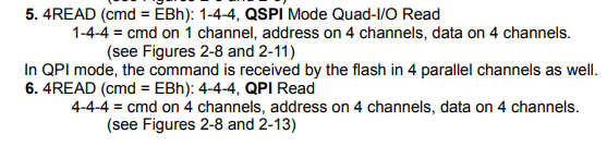

    Yes. that is exactly what the first 4 in 4-4-4 (4 command, 4 address, 4 data) means. The figure 25 in your answers shows that quad mode uses all 4 lines for the command as well as opposed to the extended mode (1-1-4), that shows the command and address on one line, and data on 4
    Here's an even clearer description from the Macronix datasheet
    From what I can see from the logic analyzer traces, Nordic only supports 1-1-4 and 1-4-4 modes, not 4-4-4. That means I cannot put the Micron NOR flash into quad mode in the register, since once that bit is set, the flash only accepts 4-4-4 (other flash chips accept both, like Macronix, as you can see here https://www.macronix.com/Lists/ApplicationNote/Attachments/1899/AN0251V1%20-%20Macronix%20Serial%20Flash%20Multi%20IO%20Introduction.pdf and copied below)
    I can talk to the Micron chip using either 1-1-4 or 1-4-4. If you confirm that there is no 4-4-4 available, I'll run a few more tests and see which of the combinations is th eone that works best in terms of speed and reliability
