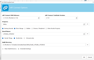

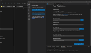

I was trying to follow the video to create a project with VS Code.

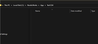

After I click the Create Application buttion, there is nothing happens. It only create a Folder with APP's name, but the folder is empty.
I have the admin right of the computer.
The folder created is empty

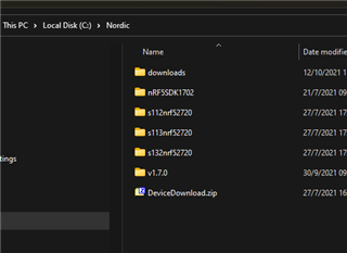

Installation path of nRF Connect
  • Hi Leo,

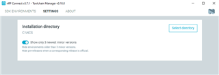

    Could you try creating the application in the same path as the nRF Connect for Desktop? I have my  nRF Connect SDK at the location C:\NCS and I create my applications in the location C:\NCS\VSC
    You could find the location of your nRF Connect SDK by following : nRF Connect for Desktop -> Toolchain Manager -> Settings

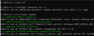

    Could you try opening the command prompt from the Toolchain Manager in nRF Connect SDK and take it to the nrf location? For eg, my nRF Connect SDK location is at C:\NCS and when I open command prompt, it points at C:\NCS\v1.7.1>
    Then, use "cd nrf "and enter the nrf folder. Then you could try entering the "git checkout v1.7.1" (in your case, v1.7.0) followed by "west update". This will download all necessary documents, (if not already installed with the nRF Connect SDK).
    After this you could try creating the application once again and let me know how it goes. In case you get any further errors do attach the screenshot of the same.
