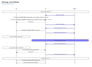

I am writing an app for nRF52840 with sdk 17.0.2 and freeRTOS.
The device should be a peripheral which a android app should be able to connect to.
Everthing works but when I use an android app for connecting like "NRF Connect" the pairing popup on android shows twice.
I am using secure manager with following options
#define SEC_PARAM_BOND 1                               /**< Perform bonding. */
#define SEC_PARAM_MITM 0                               /**< Man In The Middle protection not required. */
#define SEC_PARAM_LESC 1                               /**< LE Secure Connections  enabled. */
#define SEC_PARAM_KEYPRESS 0                           /**< Keypress notifications not enabled. */
#define SEC_PARAM_IO_CAPABILITIES BLE_GAP_IO_CAPS_NONE /**< No I/O capabilities. */
#define SEC_PARAM_OOB 0                                /**< Out Of Band data not available. */
#define SEC_PARAM_MIN_KEY_SIZE 7                       /**< Minimum encryption key size. */

Can anyone help me out?
Thanks, Andreas
  • Hi
    We have taken another look at your sniffer trace, and it seems like the peripheral is issuing a security request on connection before the client has a chance to perform service discovery. Are you calling pm_handler_on_pm_evt() from your PM callback? If so, you can try adding a delay using pm_handler_sec_delay_ms or comment out pm_handler_on_pm_evt() entirely.
    Simon
    thank you for looking into that again.
    I changed my code. Now I invoke "smd_link_secure" a few seconds after mobile gets connected. Now I see "services discovered" on my mobile app before sending "smd_link_secure". I changed to "smd_link_secure":
    sec_param.bond = SEC_PARAM_BOND; // =1
    sec_param.mitm = SEC_PARAM_MITM; // =0
    sec_param.lesc = SEC_PARAM_LESC;// =1
    sec_param.keypress = SEC_PARAM_KEYPRESS; // =0
    sec_param.io_caps = SEC_PARAM_IO_CAPABILITIES; // =3
    sec_param.oob = SEC_PARAM_OOB; // =0
    sec_param.min_key_size = SEC_PARAM_MIN_KEY_SIZE; // = 7
    sec_param.max_key_size = SEC_PARAM_MAX_KEY_SIZE; // = 16
    sec_param.kdist_own.enc = 1;
    sec_param.kdist_own.id = 1;
    sec_param.kdist_peer.enc = 1;
    sec_param.kdist_peer.id = 1;
    smd_link_secure(handle, &sec_param, true);
    But I still get "PM_EVT_CONN_SEC_PARAMS_REQ" in pm_evt_handler twice after that.
    I see pairing popup on mobile after invoking "smd_link_secure" but when I accept that I get the second "PM_EVT_CONN_SEC_PARAMS_REQ " request and after I see this a second pairing popup on the mobile.
    It looks like the mobile tries to pair again or use other settings? This is a breakpoint at second "PM_EVT_CONN_SEC_PARAMS_REQ"
