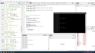

But the problem is, I can not find the define:
NRF_LOG_BACKEND_RTT_ENABLED
Should I just replace config_sdk.h with another file with the right defines ?
Using the blinky example.
  • I'm bit irritated, just thinking why aren't these things documentated, as a customer I want to concentrate on the application not 'just' getting the logging to work.....
    But anyway....
    I thought sdk_config.h is for every project the same and you can define or undefine on what you need for the project, but this isn't the case. So I took another sample project, ble_app_uart project.
    Eventually I stripped it down to just get the LOG working to this:
    static void log_init(void)
      log_init();
      NRF_LOG_INFO("Initalization done");
      // Enter main loop.
      for (;;)
        NRF_LOG_INFO("test");
        nrf_delay_ms(500);
    It still didn't work, after like a day trying and trying found out that this is working:
            nrf_pwr_mgmt_run();
      log_init();
      // Enter main loop.
      for (;;)
        nrf_delay_ms(500);
        idle_state_handle();
    Can somebody explain why the function idle_state_handle() is needed to get the log function to work ? Took me all day to find out.

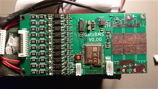

    At leasted I'm bit 'cooled' down, it is what is. I'm busy with a diy BMS:

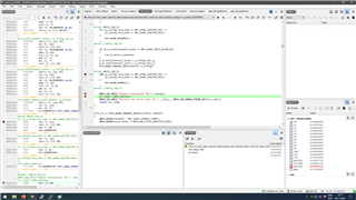

  • Very thank you, another question, how to enable the NRFX_LOG_INFO outputs ? I'm trying to setup the saadc
    Already defined:
    #define NRFX_SAADC_CONFIG_LOG_ENABLED 1
    #define NRFX_SAADC_CONFIG_LOG_LEVEL 3
    But still no logger output from nrfx_saadc.c
