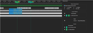

  • Hi
    I have visualized the transmission between the nRF52 and the FPGA over I2S with my ILA. The gap and the transmissions have the same length.
    So there is a transmission gap for sure.
    Please also note that I don´t use any input signal in this case. I just sample the noise of the ADC.
  • Hello Kampino,
    Thank you for this update - this is very helpful.
    How long are each of these gaps?
    In your other ticket you mentioned seeing a performance increase when changing the SDK configuration as suggested in my previous comment - could you detail this performance increase?
    Could you also possibly provide a similar plot for the case in which you were not using the SAADC to gather the I2S output?
    Thank you for clarifying - This should not matter for the frequency of the sampling / outputted samples, but it is good to know nevertheless.

  • Hi Karl,
    The gaps and the transmissions are around 1.5 ms long (~41.74 kHz LRCLK).
    Sorry, I forgot the screenshot. I think the signal quality has increased because the signal looks better (always the same height) and is less noisy (you can see it in the Fourier series).
    Sure. Please take a look at the following plots.

    Edit:
    I have decreased the sampling rate from us to ms by changing
    nrf_drv_timer_extended_compare(&Timer, NRF_TIMER_CC_CHANNEL0, nrf_drv_timer_us_to_ticks(&Timer, 23), NRF_TIMER_SHORT_COMPARE0_CLEAR_MASK, false);
    to
    nrf_drv_timer_extended_compare(&Timer, NRF_TIMER_CC_CHANNEL0, nrf_drv_timer_ms_to_ticks(&Timer, 23), NRF_TIMER_SHORT_COMPARE0_CLEAR_MASK, false);
    Edit 2:
    I have figured out that the I2S buffer isn´t filled correctly. Only the first half is filled (I suggest because of the int16 and uint32 data types):
