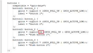

Please help me deal with the problem that P0.26 IO port is invalid as a key

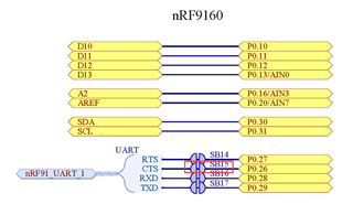

I connected the P0.26 port to GND and used SES simulation to see the following results
I used P0.26 IO port as the Button, but failed. My configuration is as follows:
1.DK:pca10090 0.8.5 (userd nRF9160)
board changed :Cut SB15
2.sdk: ncs v1.7.0
3.example path: D:\ncs\v1.7.0\zephyr\samples\basic\button
4. :board config changed:D:\ncs\v1.7.0\zephyr\boards\arm\nrf9160dk_nrf9160\nrf9160dk_nrf9160_common.dts
Thank you for all your assistance.
Peter.Min

  • Hi again, I seem to have got it working now. This node, in nrf9160dk_nrf52840/nrf9160dk_nrf52840.dts, must be disabled:
    vcom0_pins_routing: switch-nrf91-uart1 {
    	compatible = "nordic,nrf9160dk-optional-routing";
    	control-gpios = <&gpio1 14 GPIO_ACTIVE_LOW>;
    	status = "disabled";
    This must be done for the image flashed to the nrf52840, as it controls alternate routing.
