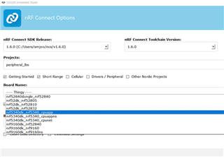

My colleague and I created ESB prx project based on SDK 1.6.0 version and nrf5340 dk.
And some source codes in ncs/nrf/samples/esb/prx/src folder are changed.
The changed files are shared with me and my colleague. But build results were different.
Only difference is Tool chain version. I can't specify tool chain version. But my colleague has 1.6.0 version.
It could effect zephyer.hex?  How could I specify tool chain version?

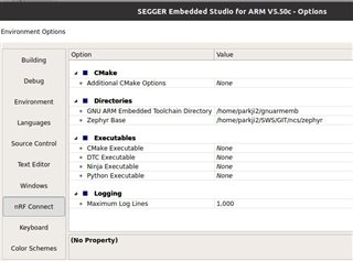

    Installing nRF Connect SDK using the Toolchain Manager will give you the option to select a specific toolchain version in "nRF Connect Toolchain Version". If you have installed it manually, the option will be NONE, as in your case.
    You should make sure to set the build environment in SES to correspond to the version of nRF Connect SDK you are using. For information about how to set the build environment manually, please see Set up the build environment in SES. For SDK v1.6.0 the recommended version of the GNU Arm Embedded Toolchain is 9-2019-q4-major. Also make sure to use the correct version of the other repositories and models used by the SDK, such as Zephyr, nrfxlib and more. If you have installed the SDK manually, you can do this by going to ncs/nrf in a terminal, make sure that you are working with the v1.6.0 tag of the sdk-nrf repository, and running "west update".

    Environment Options are configured according to your information.
    And 9-2019-q4-major is installed as gnuarmemb.

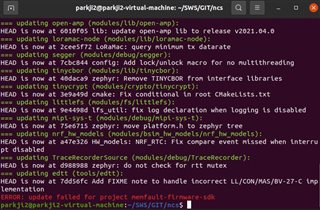

    During "west update", I got a error message which says "ERROR: update failed for project memfault-firmware-sdk".
    Could It effect build results?

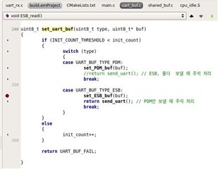

    I checked that ESB message is received periodically from Network core to Application core.
    ESB_read function send ESB_buf to set_uart_buf.
    But break point doesn't stop at UART_BUF_TYPE_ESB.
    When I used zephyr.hex of prx which are build by my colleague, It works fine.

    If you are not using Memfault in your current project the build should not be affected by this error, and Memfault is currently only supported on nRF9160-based boards, so it should not be an issue in your case.
