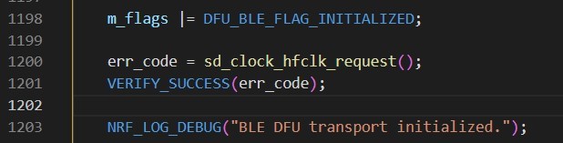

  • Hi Vidar,
    We have finished testing with WDT, and everything seems to be working okay with it. Not a single event of hang or any abnormal behaviour, which was expected with WDT.
    Now, we have updated the code to keep HFXO on as you suggested, below is the screenshot of modifications
    And updated all the devices (5 with my local dev setup) and started to test.
    It worked well every time (more than 30 times) yesterday and then I kept the setup running for normal operation overnight.
    Then when I started testing with OTA again in the morning today, one of the devices got hung during the first trial only. So above change seems not helping on this issue.
    Here, I want to note one more thing, which I forgot to mention during my first post is, the occurrence of issue is seen more obviously when you do the OTA after keeping the devices running for more time. So, if you start doing OTA just after power on, it works well, even if you do it multiple times or with a gap of say 1-2 hours it works well. But if you keep devices running for longer time like overnight (10-12 hours) and do OTA after that, it shows the issue (at least few devices). As said on my dev setup with 5 devices, it showed up on one device. But same thing I observed in our test lab too, where after running overnight, 5 to 6 devices out of 23, showed the issue.
    Please see if above observation is pointing towards any direction...
