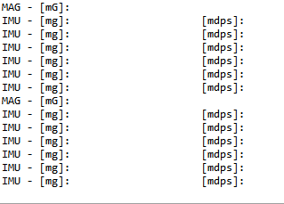

Empty readings from LSM9DS1 registers
I am trying to connect my LSM9DS1 with nrf52840, this is Arduino nano 33 BLE board. I already figured out that i had to enable it and enable TWI bus. After some readings i found example with the library for this sensor https://devzone.nordicsemi.com/f/nordic-q-a/64902/no-readings-from-lsm9ds1-using-twi-example from this post i merged it with my code (only changed twi_init) and  there is no error but i get empty values
I do not know what i can do more.
Here is my code

        sprintf((char*)tx_buffer, "IMU - [mg]:%4.2f\t%4.2f\t%4.2f\t[mdps]:%4.2f\t%4.2f\t%4.2f\r\n",
                acceleration_mg[0], acceleration_mg[1], acceleration_mg[2],
                angular_rate_mdps[0], angular_rate_mdps[1], angular_rate_mdps[2]);
        //sprintf((char *)tx_buffer, "Moj IMU - mg[0]: %4.2f \r\n", acceleration_mg[0]);
        printf(tx_buffer/*, strlen((char const*)tx_buffer)*/);

        sprintf(tx_buffer, "MAG - [mG]:%4.2f\t%4.2f\t%4.2f\r\n",
                magnetic_field_mgauss[0], magnetic_field_mgauss[1], magnetic_field_mgauss[2]);
