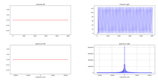

The code from above will give a pretty poor signal when I use the ADC.
I have tried to figure out the reason for this and replaced the line
I2S_BlockToFill[i] = (uint32_t)(0x0000 | (ADC_BlockToFill[i] & 0xFFFF));
with
I2S_BlockToFill[i] = (uint32_t)(0x0000 | (i & 0xFFFF));
to produce data from a ramp signal and the signal looks much better.
So it looks like the problem is based on the ADC. I have tried to use two buffers to use the same swapping buffer system as in the I2S example.
How can I improve this result?

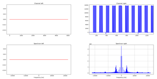

@Karl:
I have changed the sdkconfig according to your suggestions from the last thread. I have removed the legacy stuff (except the PPI and UART stuff, because otherwise, the code doesn´t compile) and changed the SAADC back from LP to normal power mode and the result looks better.
But there are some "holes" in the signal. I think there are some issues with the buffering.

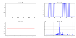

Edit:
I have visualized the transmission with my ILA. The gap and the transmissions have the same length.
So there is a transmission gap for sure.
