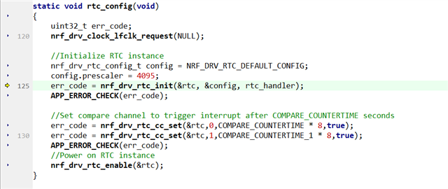

Using RTC in nrf5_SDK_for_Mesh_v5.0.0, I am trying to use RTC

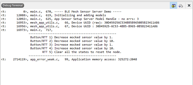

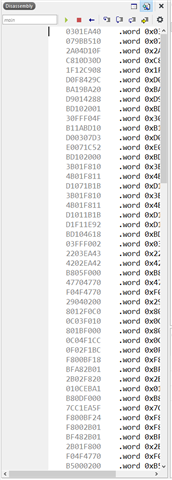

Hello , I am working on a project, Which which currently working fine , but my job is to add some feature to it. So it is a Mesh application  i need some kind of custom sleep mode , so I need an RTC_Event that will be triggered after some time, I try to achieve this using Compare event . The build very well but when I try to debug and run. It jumps to Disassemble section and throws me an error.  I am currently using RTC Instance 0, I don't know why this is happening, Also I am little new to this , Any help regarding this?.
Thanks

/** @brief Function initialization and configuration of RTC driver instance.
static void rtc_config(void)
    uint32_t err_code;
    //Initialize RTC instance
    nrf_drv_rtc_config_t config = NRF_DRV_RTC_DEFAULT_CONFIG;
    config.prescaler = 4095;
    err_code = nrf_drv_rtc_init(&rtc, &config, rtc_handler);
    //Set compare channel to trigger interrupt after COMPARE_COUNTERTIME seconds
    err_code = nrf_drv_rtc_cc_set(&rtc,0,COMPARE_COUNTERTIME * 8,true);
    err_code = nrf_drv_rtc_cc_set(&rtc,1,COMPARE_COUNTERTIME_1 * 8,true);
    //Power on RTC instance
    nrf_drv_rtc_enable(&rtc);
RTC Configuration function

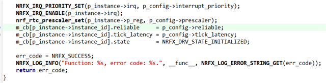

Disassembly Section
Traceback to Error
