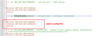

for my nRF52840 application made with the SDK v17.0.2 and S140 Softdevice I'm adding the peer module to a peripheral device example (UART with SAADC with timer based execution) in order to increase the security aspect.
Following many different thread I've added (I think...) all the C file for the peer module and FDS but, I've already added the nrf_ble_lesc.c file at the nRF_BLE file group in my project and I've also enabled into the sdk_config.h file the PM_LESC_ENABLED so what I've to do in order to get all working and avoid this missing function errors?
Looking through the source file nrf_ble_lesc.c I see this conditional check:
#if NRF_MODULE_ENABLED(NRF_BLE_LESC)
#include "nrf_ble_lesc.h"
#include "nrf_crypto.h"
the code included by the conditional statement #if is grayed out so it means that the module NRF_BLE_LESC is not enabled, looking inside the sdk_config.h file there are no label related this type of module, only the PM_LESC_ENABLED label is present.
Searching through all the SDK files for the key NRF_BLE_LESC give no results so how is possible to activate this module?

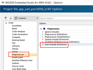

    Other than the source .c files is also necessary add related include path inside the common option of the project then:
    select the Common profile:
    then select Preprocessor and then select the User include Directories:
    so by comparing the example design and the own design add the necessary path, in my case was the following ones:

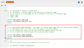

    Inside the config file set:
    PEER_MANAGER_ENABLED
    PM_LESC_ENABLED
    FDS_ENABLED
    add following lines to the config files:
    in order to include the nrf_ble_lesc.c file also add the following line to the sdk_config.h file:
