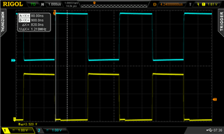

Before doing any rework, I loaded a simple program that enables the USB peripheral and toggles the D+/- lines like this on the pcb that was not enumerating.
HAL_USB_SERIAL_begin();
while(1){
        nrf_usbd_dpdmvalue_set(2);
        nrf_usbd_task_trigger(NRF_USBD_TASK_DRIVEDPDM);
        HAL_CORE_delay(1);
        nrf_usbd_dpdmvalue_set(4);
        HAL_CORE_delay(1);

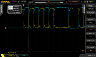

The toggling is seen (img below) on the scope once 5V is provided to the board that enables the USB peripheral. So the D+/- pins are connected to the USB connector!
On both PCBs the USB signal integrity looks ok.

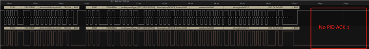

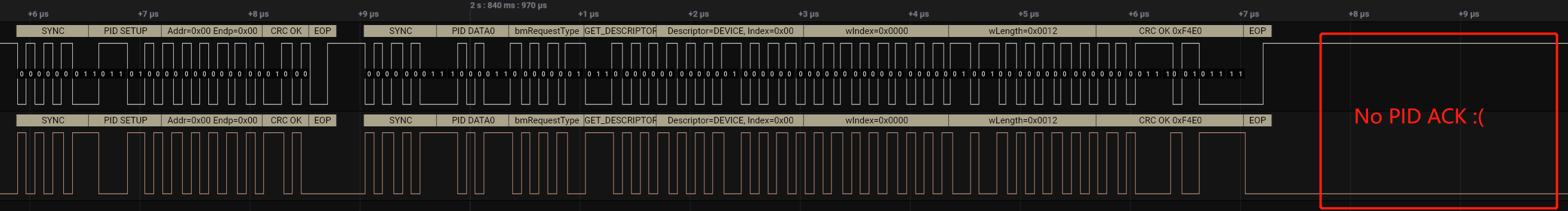

On the data side, I can notice the PCB that has the issue is not replying to the get descriptor request.
/resized-image/__size/756x102/__key/communityserver-discussions-components-files/4/2d20d7b0cd12478d3c86f16707995c0.png

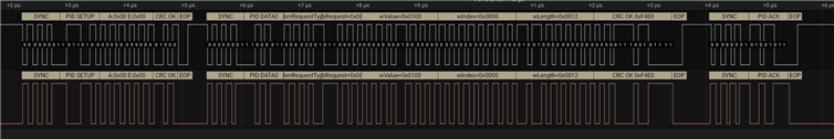

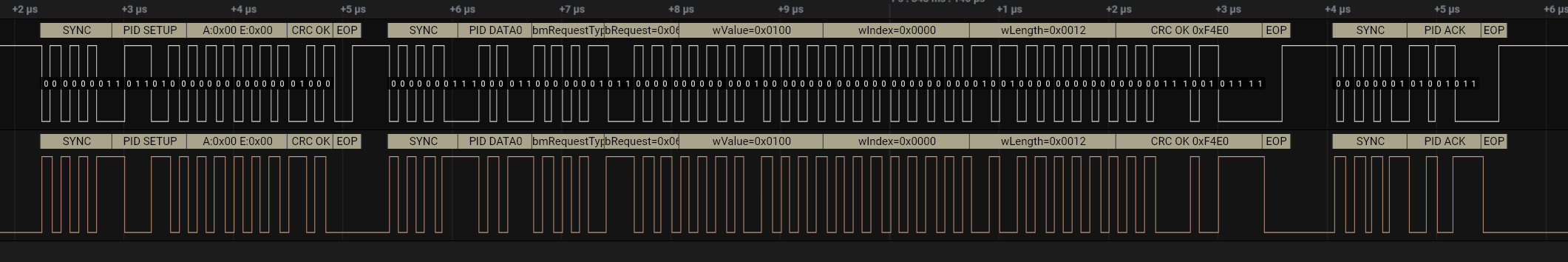

On the PCB that works, there is a PID ACK present.
/resized-image/__size/755x126/__key/communityserver-discussions-components-files/4/c17c00081fb2f02bfed2d87ac858056.png
