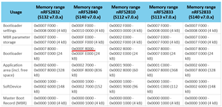

    I have another question. Since there is no bootloader example for the NRF52833 in the SDK 16.0.0, I downloaded the SDK 17.1.0. Now I am trying to build a bootloader based on the secure_bootloader_usb_mbr_pca10100e because it already has the crypto needed (when migrating from a 10065 example we had to do this manually). I had to download and build uECC. I could flash the bootloader to our custom PCB. Also I could perform
    nrfutil dfu usb-serial -pkg blinky_mbr.zip -p COM16
    just like before with the dev kit. It worked. Now I want to do the same thing with our custom .zip. I created custom public and private keys and provided the public one to the bootloader. When executing
    nrfutil dfu usb-serial -pkg release_package.zip -p COM16
    I get following error message:
      [------------------------------------]    0%                                                                                                                                                                                               Traceback (most recent call last):                                                                                                                                                                                                             File "C:\Users\gv9479\AppData\Local\Programs\Python\Python39\lib\runpy.py", line 197, in _run_module_as_main                                                                                                                                   return _run_code(code, main_globals, None,                                                                                                                                                                                                 File "C:\Users\gv9479\AppData\Local\Programs\Python\Python39\lib\runpy.py", line 87, in _run_code                                                                                                                                              exec(code, run_globals)                                                                                                                                                                                                                    File "C:\Users\gv9479\AppData\Local\Programs\Python\Python39\Scripts\nrfutil.exe\__main__.py", line 7, in <module>                                                                                                                           File "C:\Users\gv9479\AppData\Local\Programs\Python\Python39\lib\site-packages\click\core.py", line 1128, in __call__                                                                                                                          return self.main(*args, **kwargs)                                                                                                                                                                                                          File "C:\Users\gv9479\AppData\Local\Programs\Python\Python39\lib\site-packages\click\core.py", line 1053, in main                                                                                                                              rv = self.invoke(ctx)                                                                                                                                                                                                                      File "C:\Users\gv9479\AppData\Local\Programs\Python\Python39\lib\site-packages\click\core.py", line 1659, in invoke                                                                                                                            return _process_result(sub_ctx.command.invoke(sub_ctx))                                                                                                                                                                                    File "C:\Users\gv9479\AppData\Local\Programs\Python\Python39\lib\site-packages\click\core.py", line 1659, in invoke                                                                                                                            return _process_result(sub_ctx.command.invoke(sub_ctx))                                                                                                                                                                                    File "C:\Users\gv9479\AppData\Local\Programs\Python\Python39\lib\site-packages\click\core.py", line 1395, in invoke                                                                                                                            return ctx.invoke(self.callback, **ctx.params)                                                                                                                                                                                             File "C:\Users\gv9479\AppData\Local\Programs\Python\Python39\lib\site-packages\click\core.py", line 754, in invoke                                                                                                                             return __callback(*args, **kwargs)                                                                                                                                                                                                         File "C:\Users\gv9479\AppData\Local\Programs\Python\Python39\lib\site-packages\nordicsemi\__main__.py", line 1022, in usb_serial                                                                                                               do_serial(package, port, connect_delay, flow_control, packet_receipt_notification, baud_rate, serial_number, False,                                                                                                                        File "C:\Users\gv9479\AppData\Local\Programs\Python\Python39\lib\site-packages\nordicsemi\__main__.py", line 978, in do_serial                                                                                                                 dfu.dfu_send_images()                                                                                                                                                                                                                      File "C:\Users\gv9479\AppData\Local\Programs\Python\Python39\lib\site-packages\nordicsemi\dfu\dfu.py", line 127, in dfu_send_images                                                                                                            self._dfu_send_image(self.manifest.application)                                                                                                                                                                                            File "C:\Users\gv9479\AppData\Local\Programs\Python\Python39\lib\site-packages\nordicsemi\dfu\dfu.py", line 95, in _dfu_send_image                                                                                                             self.dfu_transport.send_init_packet(data)                                                                                                                                                                                                  File "C:\Users\gv9479\AppData\Local\Programs\Python\Python39\lib\site-packages\nordicsemi\dfu\dfu_transport_serial.py", line 256, in send_init_packet                                                                                          self.__execute()                                                                                                                                                                                                                           File "C:\Users\gv9479\AppData\Local\Programs\Python\Python39\lib\site-packages\nordicsemi\dfu\dfu_transport_serial.py", line 421, in __execute                                                                                                 self.__get_response(DfuTransportSerial.OP_CODE['Execute'])                                                                                                                                                                                 File "C:\Users\gv9479\AppData\Local\Programs\Python\Python39\lib\site-packages\nordicsemi\dfu\dfu_transport_serial.py", line 504, in __get_response                                                                                            raise NordicSemiException('Response Code {}'.format(                                                                                                                                                                                     pc_ble_driver_py.exceptions.NordicSemiException: Response Code InsufficientResources
    Is this related to ressources in a memory sense?

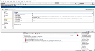

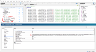

    Here is our layout. Please correct if anything is wrong.

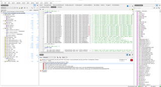

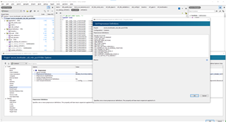

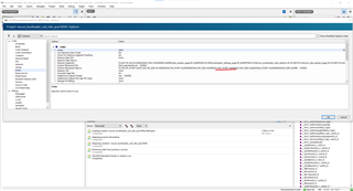

    Yes, this would be resources regarding memory. Either your application is too large or memory is configured incorrectly. Please see Memory layout to see where different firmware components are located.
    Are you using dual-bank or single-bank updates? What are NRF_DFU_SINGLE_BANK_APP_UPDATES and NRF_DFU_FORCE_DUAL_BANK_APP_UPDATES set to in sdk_config.h in the project?
    Marte
    single bank would be enough.
    #define NRF_DFU_SINGLE_BANK_APP_UPDATES 0
    #define NRF_DFU_FORCE_DUAL_BANK_APP_UPDATES 0
