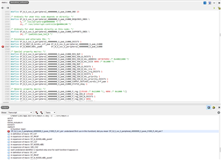

For example, using the .overlay file and the code shown for the 9160DK and turn to the following error:
'DT_N_S_soc_S_peripheral_40000000_S_pwm_21000_P_ch1_pin' undeclared (first use in this function); did you mean 'DT_N_S_soc_S_peripheral_40000000_S_pwm_21000_P_ch0_pin'?
According to NCS tutorial, "The ch0-pin field is then transformed into the define DT_N_S_soc_S_peripheral_50000000_S_pwm_21000_P_ch0_pin inside <...>\light_controller\build\zephyr\include\generated\devicetree_unfixed.h and used by the driver pwm_nrfx.c through PWM_NRFX_OUTPUT_PIN()→PWM_NRFX_CH_PIN()."
Isn't supposed to make this automatically when I add more channels in the overlay file and the C code? Is this because the NCS version? I'm using the 1.6.1v and the 2.6.0v of Zephyr.
Obs: when I build this exact same code, but change the overlay file for the nrf52840DK it works.

    - I didn't send the zephyr.dts because my code gave an error in the image below and does not build.
    Looking into the devicetree_unfixed.h file, I had to add a couple of lines to each pin that I needed to use.

    After this, the code runs and works as expected.
    Even with this fix, I still have questions:
    1º Wasn't this fix supposed to happen automatically when the overlay file is configured correctly? I still don't understand how this could happen; I have attached the zephyr.dts here, perhaps you can explain why this occurs.
    0250.zephyr.dts
    2º Checking the nRF9160's datasheet, assigning up to four pins to each PWM's instance is possible. I tested this, and it works, but I need five pins to control five LED drivers. To do that, it is needed two PWM instances active at the same, such as PWM_0 and PWM_1. Is this possible? or does hardware limit it, and is one instance active at the time?
    3º In case it is limited by the hardware, is there an alternative to have PWM in the fifth pin?
    Caio.

    1. In your zephyr.dts file there is no ch-1 pin under pwm0 instance. That is the reason of falling. Our team has tested by building zephyr/samples/hello_world(NCS v1.6.1) and added nrf9160dk_nrf9160ns.overlay with the following content
    &pwm0 {
    status = "okay";
    ch0-pin = < 2 >;
    ch1-pin = < 3 >;
    Then built it with west build -b nrf9160dk_nrf9160ns and found ch1-pin under the pwm0 node inside the file build/zephyr/zephyr.dts. You can make sure to set the same name to the overlay file as the one is used to built with.
    2. Yes it is possible. You can set 4 pins from PWM0 and one pin from PWM1.
    3. No. Maximum 4 pins for each instances.
    https://infocenter.nordicsemi.com/topic/ps_nrf9160/pwm.html
    " Up to four PWM channels with individual polarity and duty cycle values"
    You can let us know the consequence of your number one query by adding ch-1 under your PWM0 instance.
    Best Regards,
    Kazi Afroza Sultana
