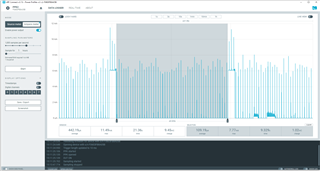

Case 1: When I am setting the following conn_params & Peripheral being connected to Central.
#define MIN_CONN_INTERVAL MSEC_TO_UNITS(7.5, UNIT_1_25_MS) /**< Minimum acceptable connection interval (0.5 seconds). */
#define MAX_CONN_INTERVAL MSEC_TO_UNITS(100, UNIT_1_25_MS) /**< Maximum acceptable connection interval (1 second). */
I can see no current peaks amidst the logs also the current consumption is between 2-3uA , as you can see in the pic below

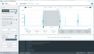

Case 2: With the following conn_params & the Peripheral is connected to Central.
#define MIN_CONN_INTERVAL MSEC_TO_UNITS(1000, UNIT_1_25_MS) /**< Minimum acceptable connection interval (0.5 seconds). */
#define MAX_CONN_INTERVAL MSEC_TO_UNITS(1000, UNIT_1_25_MS) /**< Maximum acceptable connection interval (1 second). */
So, in this case, there are current peaks as you can see in the pic below. Consequently, the current consumption has increased as well around 110uA.

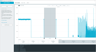

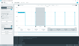

Case 3: With the same conn_params as in Case 2 but here the Peripheral is not connected to the Central.
In this case there will be no peaks similar to the Case 1, and also the current consumption is similar i.e., around 2-3 uA which can be seen from the figure below

    Is the connection interval the only thing you change between cases 1 and 2? From the consistent activity I would think this was the nRF reading data from a sensor for example, or using some other peripheral continuously. You're using a PPK2 to do all these measurements, correct? Are the sampling parameters set to the same value in case 1 and 2? I see that they're not in cases 2 and 3 for instance. Can you confirm that the device actually communicates with the central in case 1, doing this data logging at all? Also, what device is this central device?

    For the 3rd instance, I am attaching an image below with similar sampling parameters

    Can you export the PPK trace of Case 2 and upload it here on DevZone in a .zip file so we can do a review. Or alternatively zoom in on the events between the data logging events so we can get a better look at them to determine if it's just random noise or BLE events (which it looks like).
    My guess is that the slave latency is affected by the connection interval changing, and that this causes more BLE activity than you bargain for. Are any other parameters affected by the changed connection intervals?

    Thank you for the traces. It does not seem like this extra current is tied to a changed connection interval, and it seems like the spikes are consistently occurring every ~190ms so the most likely culprit is a timer somewhere that triggers and wakes the chip every 190ms. Can you provide some more details on what your application does exactly? Can you also explain how exactly you measure the current consumption. Do you measure the current on a DK or on a custom board, and do you measure the current of the entire board or just the nRF?
    What do you mean by "stops logging after 3 logs" exactly? What is one log in this context, one BLE/connection event, or one set of data in I.E. a UART log? I would imagine it goes to sleep after these three logs, which is why it stops. Please check what other functions use the connection interval defines in their functions. You can also do a diff between to make sure that only the connection interval has been changed in the two applications.
