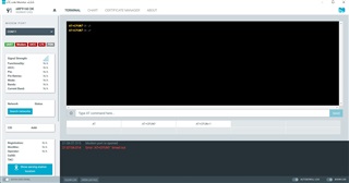

    The second problem, AT commands I mean, it happened when I updated the modem (mfw_nrf9160_1.3.1.zip) and application firmware of the asset tracker (nrf9160dk_asset_tracker_nbiot_2021-10-20_d29f1dde.hex). After that it always send me the message Error: 'AT+CFUN? ' timed out on LTE Link Monitor
  • The nRF SDK version I am running is v1.7.1.  Before updating the modem and application firmware AT commands were enabled and Modem was green. I send you a screenshot of LTE Link Monitor
    below is the output of logfile in LTE Link Monitor:

    2021-11-22T19:03:21.643Z DEBUG modem >> AT+CFUN?
    2021-11-22T19:03:22.643Z ERROR Error: 'AT+CFUN?
    ' timed out
    2021-11-22T19:06:52.684Z INFO Modem port is closed
    2021-11-22T19:06:57.515Z INFO Modem port is opened
    2021-11-22T19:07:03.004Z DEBUG modem >> AT+CFUN?
    2021-11-22T19:07:04.014Z ERROR Error: 'AT+CFUN?
    ' timed out

    Thanks for sharing these details. What version of the nRF9160DK are you running? I tested here and noticed that my LTE Link Monitor had the wrong COM port (will investigate internally). Could you please try to change the modem port in LTE Link Monitor:
    Note that the nRF9160DK has three virtual COM ports.
