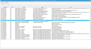

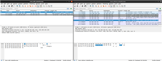

CONFIG_NRF_MODEM_LIB_TRACE_ENABLED=y is only capturing partial packets
I have CONFIG_NRF_MODEM_LIB_TRACE_ENABLED=y.  And when I capture and convert to wireshark trace I might see a couple of random packets captured.  I am doing 2 separate TLS connects() and handshakes.  So I would definitely expect to see much more than a few random packets.

  • Hello Loren,
    which NCS and mfw version are you currently using? Do you observe the same behaviour when recording a trace from one of our nRF9160 applications/samples as well?
    Otherwise, it would be interesting to have a look at the binary dump.

  • Hello Loren,
    Loren Rogers said:
    It also contains a custom https_client in the nrf9160 samples folder which allows for mbedtls.
    I assume you are simply talking about the https_client application in the sdk-nrf master/main branch?
    Loren Rogers said:
    My guess is there's no "hooks" in the mbedtls to capture packets?  Please advise.
    Yes, capturing packets in a modem trace should be independent of the mbedtls library. Could you provide me with a binary modem trace dump and a full application log?

  • Hi Markus,
    I'm attaching 3 files:
    1. trace_with_mbedtls.bin, 2. trace_without_mbedtls.bin, and 3. A text file containing the full log of both application runs.
    I don't believe the https_client on master/main branch has the mbedtls changes.  At least it didn't as of 1.7.1.
    trace_with_mbedtls.bintrace_without_mbedtls.bin

    thanks a lot for the traces and log!
    The trace_with_mbedtls stops right after connect request to the server.
    Comparing the two .pcaps in Wireshark shows that the beginning is the same, which is expected.
    Could you possibly have stopped the recording of trace_with_mbedtls a little bit too early?
    Markus
