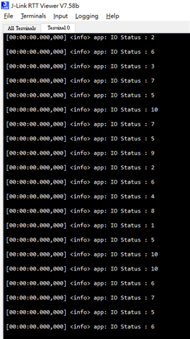

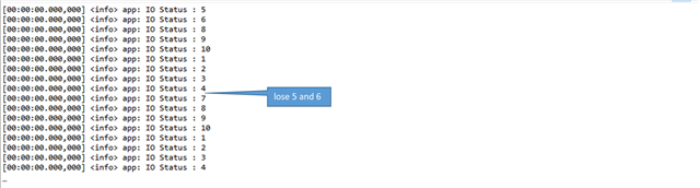

    The question is : IO_STATUS + 1 once every 1 second, and use RTT printing, confirmation will enter the implementation of this section every 1 second, but sometimes the print will lose information, and the J-LLINK Viewer is seriously lost.

    Can you upload the current version of your project so I can give it a try here? You should not be able overflow the log buffers when logging at this rate.

    Attachment is my program.Thank you for your help.
    But today i retry this project it seem normal. I have no idea.Maybe Segger Terminal and J-Link RTT view can not enable at the same time?
    Kai
    libuarte_Kai3.zip
  • Hi All,
     Segger Terminal and J-Link RTT viewer can not enable at the same time is true.
