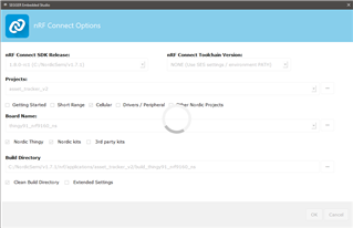

  • Hello again,
    I've also successfully tested using Segger Embedded Studio from the Toolchain Manager after updating nRF Connect SDK to main branch. When opening a nRF Connect project in SES, it will automatically show the main release, and choose "None" as toolchain version. "None" just means none specific.
    This means it chooses what is configured in the path, in this case the path where we checked out main. This will be the path to whatever version you opened Git bash from, in the Toolchain Manager.
    If you opened Git Bash from e.g. v1.6.1, the path would reflect that as well.
    Øyvind
