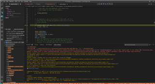

I'm currently trying to find where the MCU get stuck using the debugger.
