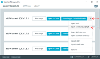

I've installed VS Code 162.3 on Windows 10 machine via Toolchain Manager. I've also installed nRF Connect extensions for SDK v1.7.1.
The build system works under NCS v1.7.1, but if I open a PS terminal "west --version" is not recognized as a valid command.
Isn't VS Code using west for building ?
How to get west installed ?
Another miss is the "Debug with Ozone" icon under ACTIONS pane.
Thankx
    When you install the toolchain using the toolchain manager the tools are not in the path (which is intentional to keep things separated). However, you can for instance open a terminal window with this in the path from the Toolchain Manger like this:

    If I run the power shell by right-click over the application icon, west is recognized.
    If I run the power shell by clicking the "+" button in the terminal window, west is not in scope.

    Perhaps, but it is expected. In the first case, you use the specified NCS toolchain environment. in the seconds, you use your normal environment (whatever is in the path).
