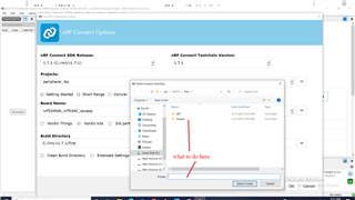

I am new to Nordic. I installed nRF Desptop Connector. I have opened succesfully the sample nRF projects. Now, I want create my own new nRF Connect Project. I tried two ways:
1. First created a new folder named "First" in "C:\nrc\v1.7.1". I tried to create a new project using nRF Connect Options in this folder. But there is option to open either existing nRF project only. see first image ...

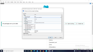

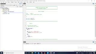

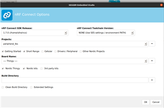

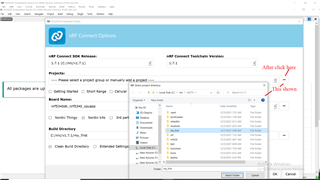

2. I creted a new project in SES without nRF Connect SDK in the above folder. The default "Hello World" code builds successfully.see images 2 and 3. But, I want to know how to open/ convert this new project as nRF Project, see image 4.

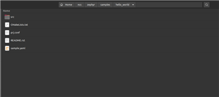

    A project in nRF Connect SDK is a folder with at minimum the following parts:
    CMakeLists.txt
    prj.conf
    a src folder with .c file(s) inside
    Here is an example of a minimal application
    The CMakeLists.txt will point to your C files, for example like this:
    "target_sources(app PRIVATE src/main.c)"
    When you choose "project", Segger Embedded Studio will only look for a folder containing the mentioned files.
    To create a new project, you need to find an example, then copy it manually.
    Then you can chose this new folder as if it were an existing project.

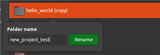

    Steps to copy project:

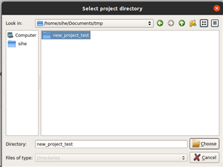

    1. Find similar project. Let us use hello world for this example, as it is an easy sample.

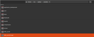

    Then copy the whole folder:
    And rename it:
    Let us move the folder to another place, to showcase this. I put it in Documents/tmp:

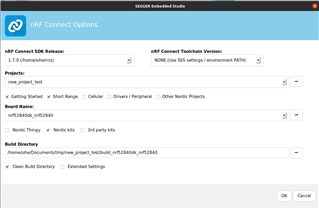

    Now in Segger Embedded Studio:
    Chose the new folder:
    And the finished options for opening the project should look something like this:
    Disregard my "nRF Connect SDK Release" and "nRF Connect Toolchain Version". These are different due to me using Linux.
    Does this explain what you want to know?
