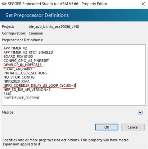

Hello fellow users, I've have stumbled upon an issue within my alteration of the ble_app_blinky example project.
I am using the PAN1781 nrf52820 evaluation board, which meant there was no available version that I required in the examples (as I require a PCA10100). To solve this, I copied the PCA10056 with S140 and edited it using Creating SES projects for PCA10100 or other boards - Nordic Q&A - Nordic DevZone - Nordic DevZone (nordicsemi.com), which can be seen in my project options.  Also to mention, I am using softdevice S140.
After this, I received an issue within sdk_config.h relating to the UARTE's enabled, I attempted to use Multiple definitions of UARTE0_UART0_IRQHandler - Nordic Q&A - Nordic DevZone - Nordic DevZone (nordicsemi.com), disabling UARTE and enabling UARTE1. Finally, I disabled UART_LEGACY_SUPPORT as recommended in comments of https://devzone.nordicsemi.com/f/nordic-q-a/48318/multiple-definition-of-uarte0_uart0_irqhandler
My issue is that although my project is building, connecting to the target J-link (nrf52820), and downloading without any stated errors (also verifying with no errors); but the board does not show on the nRF Blinky app when I attempt to find it on my iPhone 8. I am stuck as to what to do since there are no errors, so any input on possible solutions would be greatly appreciated :)
I also know this same setup worked on a different laptop and phone, so wasn't sure if that could have had any sort of effect, or whether I have just configured wrong. I am using Windows 10, and my sdk version is 'nRF5_SDK_17.1.0_ddde560'. I have also attached a zip of the project; I'm using SEGGER Embedded Studio for ARM 5.60a to open and run the project.
The .zip file should contain all parts required for the example alteration, thanks :)
