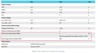

1.How to test the ESD Human Body Model (HBM) performance of nRF5340?
2.How to test ESD Charged Device Model (CDM) performance of nRF5340?
Thank you for all your assistance.
Peter.Min
This is a test that is done as part of the qualification of the device with very specific test conditions. .You will normally do ESD testing with the device mounted on a PCB in a housing in a final product. There are different standards that describes how to do this, one is CENELEC EN 61000-4-2
