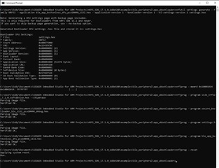

  • The "No bootloader was found" error indicates that the bootloader start address is not stored in the UICR register at address 0x10001014. This register gets set when you program bootloader. Maybe it gets erased when you program the application?
    You can use nrfjprog to check the register value:
    > nrfjprog --memrd 0x10001014
    And also to program the hex files:
    > nrfjprog --program <Softdevice> --chiperase
    > nrfjprog --program <bootloader>
    > nrfjprog --program <bootloader settings>
    > nrfjprog --program <app>
    > nrfjprog --reset
    I've attempted to execute nrfjprog commands you wrote above, and here's the result:
    Basically my custom board stuck at keep advertising DFUTarg and can't enter the buttonless_dfu app. Attempting to perform any DFU updates after connecting it to my Android-nRF Connect did nothing to my board. I got the same debug info when I did debugging through SES (No firmware to activate).

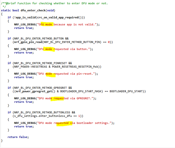

    The "No firmware to activate." message is expected when when you program everything with nrfjprog. The question is why it falls back to DFU again. Are you seeing any of these messages in your log output:
  • it was "DFU mode requested via button", which doesn't make sense considering I downloaded buttonless_dfu app.

    EDIT:
    I realized the part I missed. removing (nrf_gpio_pin_read(NRF_BL_DFU_ENTER_METHOD_BUTTON_PIN) part in bootloader solved my issue. I've been looking around on buttonless_dfu, that I didn't pay attention to bootloader.
    Thanks for pointing out.
