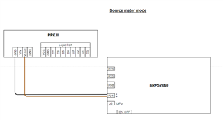

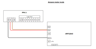

I have just purchased the PPK2. I've noticed that there two methods two measure the current
1. Source meter (the PPK2 provides power to the DUT)
2. Ampere meter (use external power source for the DUT)
I am using the nRF52840 as DUT.
- Is there a recommended way for measuring the current (source vs ampere meter methods)?
- In case of Ampere meter mode, should I avoid powering the DUT from USB, or it doesn't matter?
- The source meter mode has the same accuracy as the ampere meter mode?
- If I want to use the digital channels I must connect Vcc and GND as well?
- In case of ampere meter mode how is the wiring between PPK2 and nRF52840 (I didn't find any documentation, I've just found this getting started tutorial but the wiring isn't clear). Could you confirm the following wirings?

    2. Ampere meter mode:
      1. Measure current through the current measurement header (P22) (cut SB40)
      2. SW10 to off
      3. SW6 to DEFAULT
      4. Unplug the USB and power with a 3V clean supply on P21.
      5. Alternatively, you can leave the USB cable connected (and remove the supply on P21), but you may get 10 uA increased current, because of noise.
    The wiring in the drawings you posted is correct.

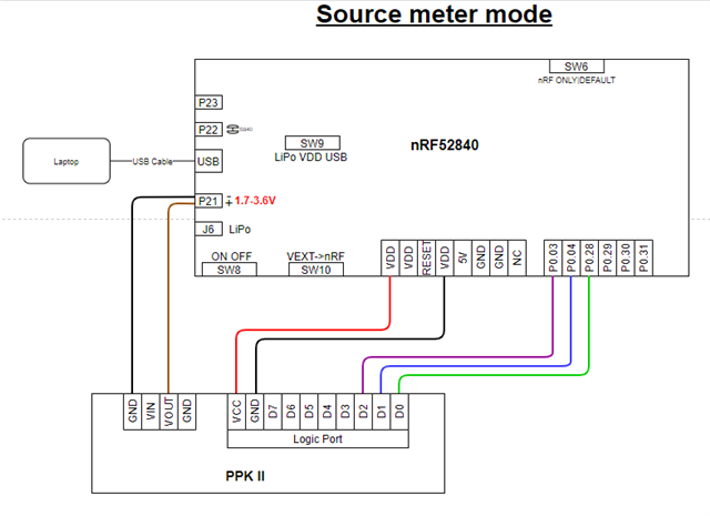

    To use the logic port the connection is like this?
  • Hi
    Yes, VCC on the logic port needs to be connected to VDD on the DUT to get the correct voltage reference. The reason why there is a separate pin for this is that you can measure current on one DUT and digital signals on another DUT with a different voltage level, e.g. BLE peripheral and central.
    GND is common for both the current measuring port and the logic port, so only one wire is needed from GND on the PPK to GND on the DUT. (There is a small mistake in your drawing. GND is connected to VDD)
