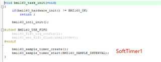

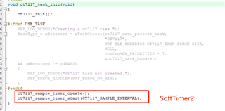

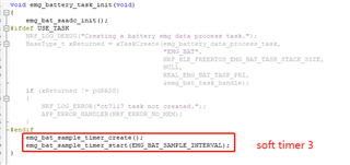

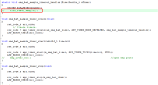

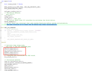

But I have a new problem, I verify my own program (two threads are added based on ble_app_hrs_freertos, and three timers are created using app_timer_create) on this smallest system board (without connecting any peripherals) . If I only start two timers, the power consumption is UA level, but when I start the third timer, the power consumption reaches about 2mA. It's strange. Can you help me see the reason?
The following is a snippet of my program
If I don't start soft timer3,the power consumption is uA level,if I start soft timer3,the power consumption is about 2mA。
