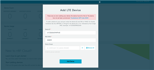

Hi, Recently I  bought the nRF9160DK for development and during get start i am facing some issues
for get starting i am use this video as reference https://www.youtube.com/watch?v=rMvW3HXLErk
1. Erase device
2. uploaded  nrf9160dk_fw_2021-10-20_d29f1dde/img_app_bl/nrf9160dk_asset_tracker_ltem_2021-10-20_d29f1dde.hex
3. update the modem file mfw_nrf9160_1.3.1
4 created nrf cloud account
5. while adding provision devices generated the .json file and upload the file to the device using nrf connect / LTE monitor
uploaded certificate after setting the AT+CFUN=4
6. added iBasis esim (my region is INDIA will it works?)
7. after activation while setting the LTE device shows an error  40412

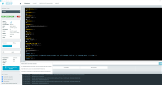

  • Hi Øyvind,
    I have followed the same steps 1,2,3,5
    and i have LTE Jio sim. (but it is not an NB-IOT sim) only LTE sim.
    I have inserted and powered up . But only LED3 is blinking and no LED4 blink or SIm is not enabled .in the screenshot the LTE tab is not enabled . please check and is that i need to configure LTE sim in nrf cloud or in the device using any AT commands .
    in device switch1 and switch 2 set to N.C (right side)
    I didn't connect any external antenna for LTE and GPS
