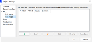

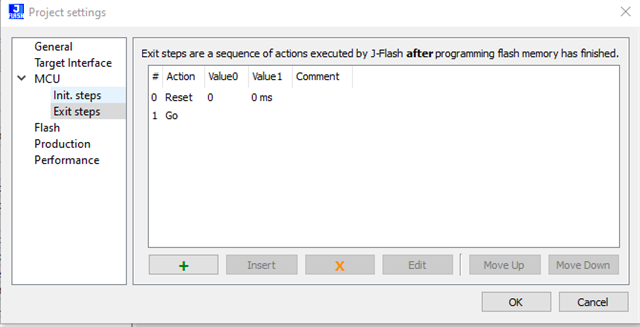

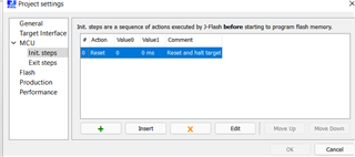

Combined hex file flash download to nrf2840 need a power off and power on to run the code
dear nordic team,
                           I was working on nrf52840 with nrf5sdk v 17.0.1 and sd v7.3 .Im using mergehex tool to combine bootloader+softdevice + App to download it to flash(using jflash tool) it is download fine  but the issue is we need to power off and then power on the device to get the code to run that we have downloaded else the code is not running.Is this an issue then how it can be solved ?.with downloading the application code and softdevice using segger ide there is no issues  without combining .thanks in advance
