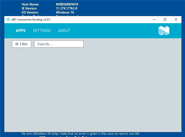

  • The fact is that ncs does not work on Windows 10 VM neither.
    I have tried v3.9.1 and 3.7.1 but no any error message.
    In v3.5.0, there is an error message.
    Unable to load apps: Unable to parse C:\Users\IEUser.nrfconnect-apps\apps.json: Unexpected token  in JSON at position 0

  • Update: V3.9.2 works in Windows 10. It is released 10 hours ago.
