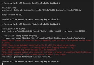

ERROR: Serial number of connected device (20090928) does not match the expected serial number 123456. VS Code

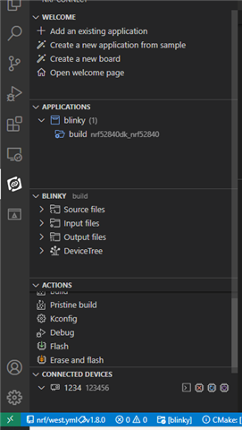

Hi, I'm trying to run samples provided by Nordic but I fail. My problem is west can not find my Jlink.
I can flash the chip (nrf52840 custom board) using nrfjprog
but in vs code I fail. I also flashed the chip in segger embedded studio and it worded.
OS Windows 10
nrf connect SDK V1.8
nrf connect for vs code v2021.12.137
west version 0.12.0
nrfjprog version: 10.15.0 external
JLinkARM.dll version 7.56a
TNX

    No, I can't find the device in connected devices list.
    I followed tutorial Nordic tutorial.

  • The problem was the debugger firmware's. It was too old, after testing with newer firmware it solved.
