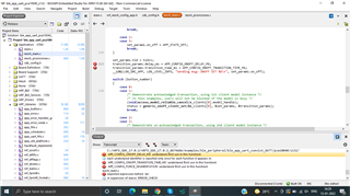

    i pasted it on "C:\nRF5_SDK_17.0.2\nRF5_SDK_17.0.2_d674dde\examples\ble_peripheral " on that path..
    first it show "log_beckend.rtt error" but after included the libarary it sloved...
    but now it show
    can you help me to sort it out.?
    thanks in advace.
    The example is from SDK v4.0 and to be used with SDK v16 so there is some slightly changed needed. I would suggest to have a look and check for the change that I made (you can use diff or use a compare tool in Notepad++ for example) and apply the same change to SDK v17 and the example in SDK v5.0.

    Please find the application for SDK v5.0
    Please make sure you have defined the SDK_ROOT and MESH_ROOT in SES correctly, pointed to the right SDK.
    What I edit is marked with "//GATT_EDIT********************"
    7536.ble_app_uart_coexist_GATT_SDK5.0.zip
