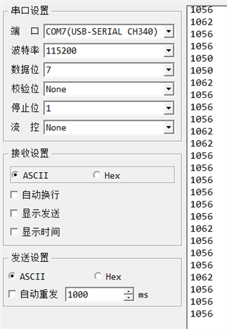

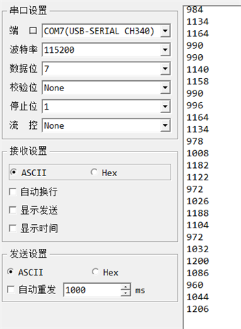

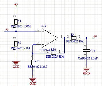

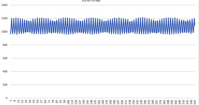

Hello, I test SAADC on nRF52810, when I short gound to AIN0, the output is 0 normally, and when I add nothing to Pin I0(AIN0), the output is around 1056(Figure0), however when I just connect Dupont Line without anything to Pin I0(AIN0), the output seems have sin noise, the output data and graph is showing in Figure1 and Figure2, then I cant read useful information from AIN0 when I connect load with Dupont Line. The Amplifier of  AIN0 is shown in Figure3 and A0 is connect with AIN0 shown in Figure4. Then configuration of SAADC and test case is shown below:
what should I do to solve this problem, wishing for reply

    I don't see any issue with this, what do you expect to see on a floating ADC line if not a sine wave like this? I'd recommend setting a load on it (probably somewhere in the Mega-Ohm range) to get rid of this sine wave.
    Other than that I think your schematics look fine, but keep in mind that you need to configure your project to use the internal RC oscillator as a clock source for the 32.768 kHz LF clock when you don't have an external LF crystal on P0.00 and P0.01. The example projects in our SDK generally configure the nRF to use the external crystal by default.
    Simon
  • Hello, thanks for your reply, I finally found that the noise come from the computer power adapter, thank you very much for your help:)
