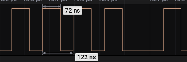

  • I have changed it to DSB and the timing now is as given below. Could you please explain me how to derive 72 ns and 50 ns from the code ? How many CPU cycles does DSB take ?
  • __DSB() causes the MPU to wait until the port write high instruction completes, which although the port pin 16MHz clock is synchronous to the instruction 64MHz clock the two may be out-of-phase with the port action depending on previous instructions, and the state of the instruction pipeline. Let's say that takes 62.5nSec + n = 72 nSecs where 62.5 nSec is a single cycle at 16MHz. Same for the port write low. What next? A jump instruction, as  you are using a while(1) loop. That may be taking (122-72) - 60 nSecs to complete.
    Prove this by a series of port set high / reset low instructions and then see what timing you get. 100 such high/low pairs in the while(1) loop might be closer to (72+72)x100 nSecs or perhaps slightly better.
    Finally results assume the crystal-derived HFCLK is enabled. Enabling instruction cache will change from 2 wait states to 0 wait states in the instruction timing, though in this loop that may not change timing, I'd have to check in the ARM Cortex-M4 manual.
    If you really want 8MHz use the hardware PWM peripheral which can give 8MHz max rate, no timing issues
