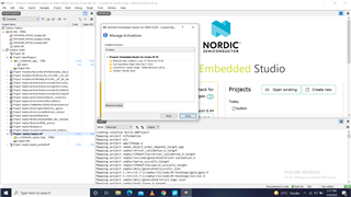

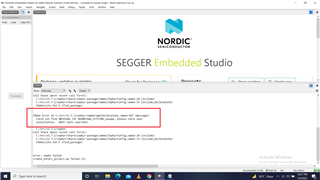

I copied the button project from samples in other drive. Copied the ../boards/arm/nRF534DK_nRF5340 in the new project folder. Then, I changed the names of board in all file as explined in video https://www.youtube.com/watch?v=KSivO9Cf1TE. When, try to create project usinf nRF Connect, error: can not create project .... the error shows incomplete comfiguration. The whole project in attachement.   I am using the free version of SES. The liscence configuration in shown in atached image.    5050.bms.rarbms1.rar  I tried other way also. I copied the ../boards/arm/ nRF5340DK_nRF5340 to location of new project. modified the CMkaelsits file and tried to create project usnf nRF Connect SDK. Same error appears. This project also in attched file bms1.

  • Dear Simon, I followed the procedure suggested by you to change board name. The custom name of my project is bms. When, project is created nRF Connect SDK , I selected my custom project and manually added the board from same directory. The bms project folder is in attachement. I am using nRF V1.71. The error as shown in attached is shown an project is not created.
    6406.bms.rar

  • Dear Simon, I also copied the my custom board to nrc/........ The CMake and Buil Solution now run successfully. But, is it mondatory to keep custom board in default directory of nrc ? If, a custom path of board is to be provided, how can that be done ? please, test at your end and then guide me .
