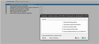

  • restart the capture
    That solve my problem completely, I am able to follow the packets on a Connection.

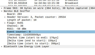

    Could you resolve a final doubt of my data sniff??
    I configure Conn_interval=32.5ms
    So as I understand is, every 32.5ms aprox Master is going to send a packet to Slave(Empty PDU), if the slave have data to send then send data(L2CAP Fragment Start), the next Empty PDU of the Master the Slave send an ATT command saying something more. Could you explain-me a little bit what is the order and sense of every packet? And if you could suggest me some link to a more deep information.
    So central side isn't going to receive a message(23 bytes) in one conn_interval, otherwise is going to receive data once every 4 conn_interval. Is this normal??
    On another way as you can see on the sniff Master is sending the Empty PDU every 2*Conn_interval=65ms, is this correct??
    Sorry for make you spend more time with me, but if I achieve understand this I think that no more questions i would do on the future.
    I am so gratefull, regards.
  • Yes, the master seems to be skipping every other connection event in your case. It's not normal, but not unusual either. It can happen in multilink scenarios where the master is forced to drop connection events to maintain other active links. Do you see the same if you increase the connection interval a bit more?
    The master must sent a packet to start the connection, which will be an empty one if it has no data to send.
    It also looks like CONFIG_SDC_MAX_CONN_EVENT_LEN_DEFAULT is still too short for the master to have time to acknowledge (i.e. reply with an empty packet) your notification packets within the same connection event (you can see the connection event counter to the left of the "info" tab in Wireshark.
    You can read more about how the scheduling works in the Softdevice controller documentation here: https://developer.nordicsemi.com/nRF_Connect_SDK/doc/1.8.0/nrfxlib/softdevice_controller/doc/scheduling.html#controller-timing-activities-and-priorities

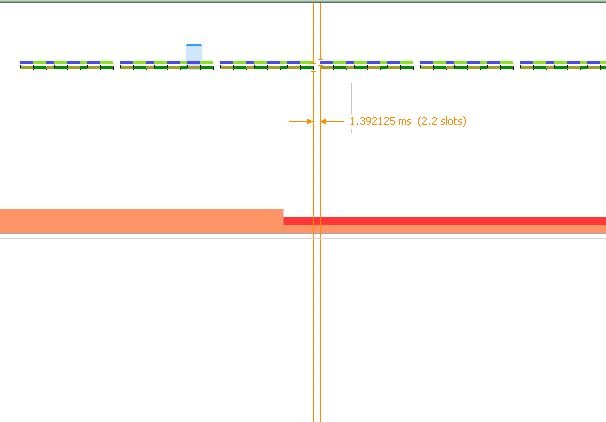

    I need a CONFIG_SDC_MAX_CONN_EVENT_LEN_DEFAULT=8000 for achieve that on one connection event receive one msg:
    If I lower Tevent 500 less i find that only 2 events of the last 4 happen on a connection event.
    So with this Conn event and following:
    Conn_interval=(CONFIG_SDC_MAX_CONN_EVENT_LEN_DEFAULT+1.4)*Nºdevices
    I achieve the maximum throughput, near to 18kbps received by central. This value still constant independently of NºDevices.
