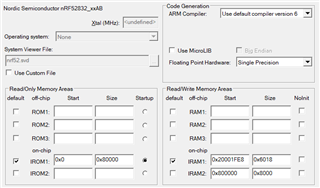

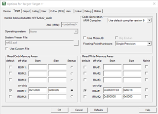

  • Thanks for your reply Simon.
    Here is my configuration:
    But in this case the pointer stucks on the 2nd level as you see so the program is not running:

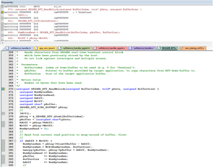

  • Here is the result when the kiel config is:
    the RTT result:
    sd_ble_enable: RAM START at 0x20001FE8
    sd_ble_enable: error 0x200061F4
    My question is why the error code is randomly changing? From where the problem comes?
