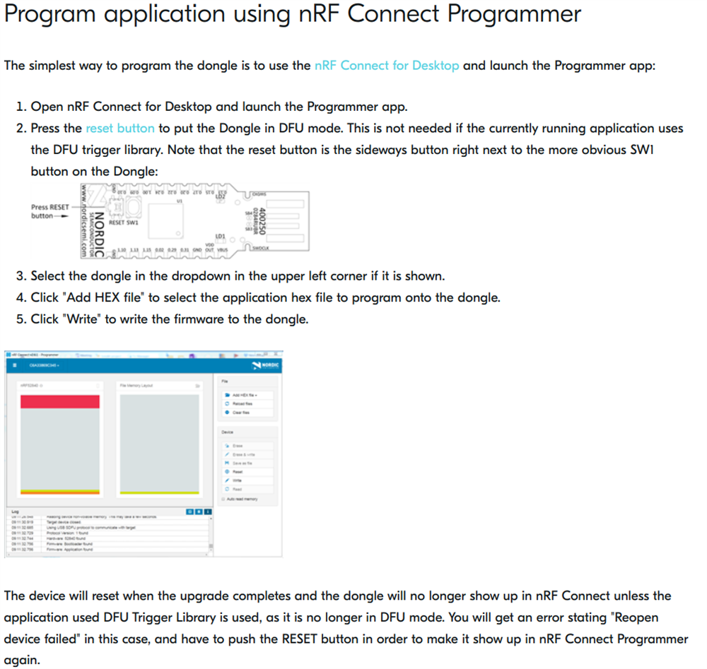

I am trying out the FOTA feature on the nrf52840 dongle. I managed to build the SMP server example and flash it using mcugr. However when i reset the device, i can't find the zephyr advertisment from the BLE. Not sure what went wrong?
Note: I am using Zephyr, nrf connect 1.5.1.
