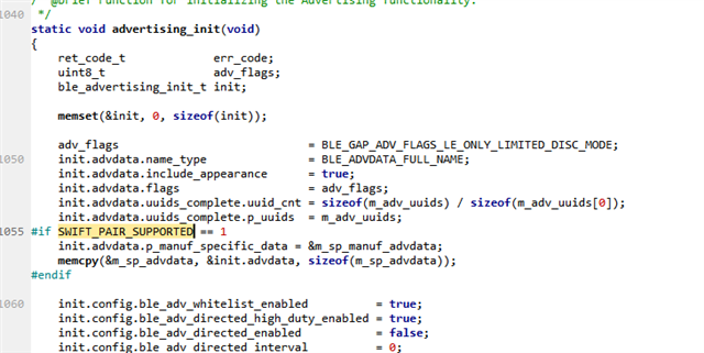

hi support team,

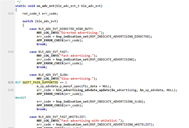

for nrf5 sdk ble_app_hid_mouse example, this example shows how to use swift pairing, it works. but I have one question for it, after I press reset button, DK will re- adv for fast adverting about 30 seconds, but OS will not reconnect it until fast adv expires and enters slow adv?
the difference between fast adv and slow adv is that there is no swift pairing infor mation in slow adv.
