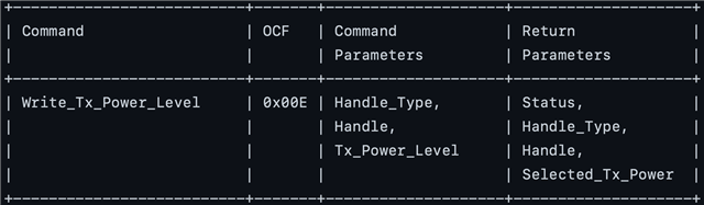

    The ogf part of the opcode has 6 bits and it denotes the opcode group field. In your case 0x3f is reserved for vendor specific command. The ocf part has 10 bits and it is known as opcode command field. A Command Complete HCI Event specifies the corresponding Vendor specific debug command opcode. For more information, please refer to the bluetooth specification.
    One good explanation of the hcitool command output can be found here.
    Setting the transmit power value is vendor specific command. Please check hci_zephyr and hci_softdevice.
    There is also an example in zephyr\samples\bluetooth\hci_pwr_ctrl.

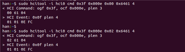

  • Hi Dejans,
    Unfortunately, I cannot set the tx power from "Write Tx Power Level" and also from bluetoothctl command.
    Below is the test result.
    Sorry that I'm not familiar w/ hci tool, could you share the hint which step or concept I missed.
    1. Write TX power, but got fail return "unknow hci command".
        sudo hciattach -s 115200 /dev/ttyACM0 any 115200 noflow nosleep
        sudo hciconfig hci0 up // bring up device
        sudo hciconfig hci0
        sudo hcitool -i hci0 cmd 0x3f 0x000e 0x00 0x6461 4 //set tx power level 4
        sudo hcitool -i hci0 cmd 0x3f 0x000e 0x02 0x6461 4

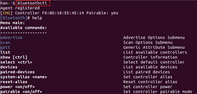

    2. bluetoothctl
    I tried to use "bluetootlctl", but i cannot find the parameter for tx power level setting from help.
    Does the command of tx power level has been hidden? or this is a sub command?

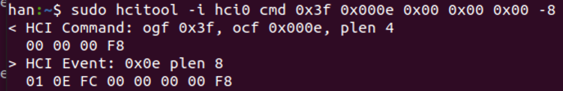

  • Hi Dejan,
    I summarize the result and it works on my side.
    Example: /1.8.0/nrf/samples/bluetooth/hci_uart
    1. Add the below setting on "prj.conf" and re-build the project.
    CONFIG_BT_HCI_VS=y
    CONFIG_BT_HCI_VS_EXT=y
    CONFIG_BT_CTLR_TX_PWR_DYNAMIC_CONTROL=y
    CONFIG_BT_HCI_RAW_CMD_EXT=y
    CONFIG_BT_CTLR_SET_HOST_FEATURE=y
    2. Use the below command to bring up
    3. use the below command to set the TX power "-8 dBm"
    sudo hcitool -i hci0 cmd 0x3f 0x000e 0x00 0x00 0x00 -8
    4. use the below command to read the TX power
    sudo hcitool -i hci0 cmd 0x3f 0x000f 0x00 0x00 0x00
