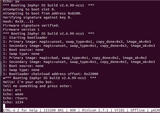

  • OK, this is great!
    Now we can try to figure out the difference in the environments -

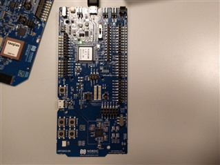

    1. How did you connect to the board? Was it using regular USB cable?
    2. What is the state of the switches on your board?
    3. Which OS & driver are you using?
    Yes, the J-Link interface USB.
    I believe it should be visible from the picture. Let me know if it's not clear.
    I run Linux from a virtual machine, using a windows 10 host and bridging the COM port. The driver should be the J-Link CDC driver for windows.
