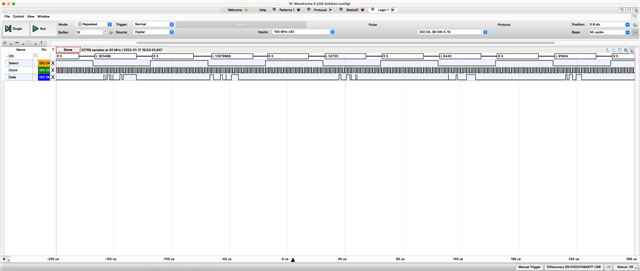

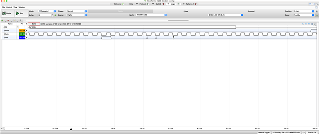

    I got the following from my logic analyzer:
    There is something wired that I did something wrong:
    1.  "spike" in the data line like the following
    2.  All "0" occurs only when WS is High
    Any suggestions on these issues or workaround, or fundamentally I cannot sample I2S data @48kHz.
    Thanks
    Anthony
