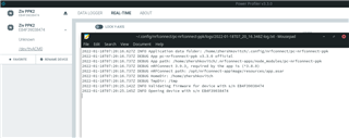

i am using ppk2 pca63100,
working on linux (manjaro), installed the nrfConnect v3.9.3 with power profiler v3.3.0
1. when i connect a device i have to close both power profiler and nrfConnect for recognision of the connected device (which i connect to the 'data/power' usb port which is strange
2. when seeing a device on the port it remains unknown and it is not recognized as ppk2 device
3. there is no 'start' or normal ui for the conected unknown ppk2
hope you can guide me what is missing or what needs to be configured
p.s. the same ppk with same cables is identified on another pc with manjaro

  • updated to j link 7.6.0 and nrf cli tool 10.15.0-0
    reinstalled the nrf connect and got this when started it :
    the link leads to what seems to be a JSON or CBOR so i don't know what that means but it does notify an issue with the app update

  • This seems to be related to the Bluetooth Low Energy app in nRFConnect. If you close this error message, what version of the BLE app is installed, and can you try uninstalling and reinstalling the BLE app? Are you still able to open the Power Profiler app?

  • tried to uninstall and reinstall both bluetooth low energy (v3.0.0) and power profiler (v3.3.0)
    none works properly
  • Is this the error you uploaded previously the only error you're able to see or are you able to open the Power Profiler app at all, or do you see a similar "Unable to download" error for the Power Profiler as well. If you're able to open the Power Profiler app now, can you try to connect and open the PPK and upload the log information from the Power Profiler app so we can take a look at it?

  • i see the error only on the first open of the nrfconnect, don't see it in the second one
    i tried to reinstall every component
    power profiler still not recognise, here is the log:
