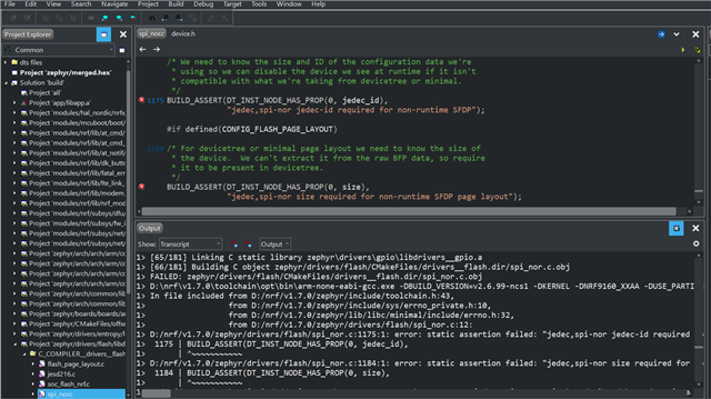

  • Hi Simon,
    Thks for your help.
    I went through the file from your sample and tried to replicate the configurations to mine, but with no success. So before coming here i downloaded your example and created a project on segger, then when i try to build the solution it gives an error
    In order to create the project i had to add to 'nrf9160dk_nrf9160_ns.overlay' &SPI3
    &spi3 {
    	status = "okay";
    	sck-pin = <8>;
    	mosi-pin = <11>;
    	miso-pin = <10>;
    	cs-gpios = <&gpio0 9 GPIO_ACTIVE_LOW>;
    	mx25r64: mx25r6435f@0 {
    		compatible = "jedec,spi-nor";
    		reg = <0>;
    		spi-max-frequency = <8000000>;
    		label = "MX25R64";
    		jedec-id = [c2 28 17];
    		sfdp-bfp = [
    			e5 20 f1 ff  ff ff ff 03  44 eb 08 6b  08 3b 04 bb
    			ee ff ff ff  ff ff 00 ff  ff ff 00 ff  0c 20 0f 52
    			10 d8 00 ff  23 72 f5 00  82 ed 04 cc  44 83 68 44
    			30 b0 30 b0  f7 c4 d5 5c  00 be 29 ff  f0 d0 ff ff
    		size = <67108864>;
    		has-dpd;
    		t-enter-dpd = <10000>;
    		t-exit-dpd = <35000>;
    	chosen {
    		nordic,pm-ext-flash = &mx25r64;
    Can you help to diagnose the issue?
  • I found the error.
    In my case as i'm using an custom board, the definition of SPI3 was on '*.overlay' and mcuboot doesn't have access to it. To solve it add this line to 'CMakeLists.txt' right after cmake_minimum_required(...)
    cmake_minimum_required(VERSION ......)
    set(mcuboot_DTC_OVERLAY_FILE "${CMAKE_CURRENT_SOURCE_DIR}/${BOARD}.overlay")
    This way mcuboot knows jedec-id and size and compiles without a problem
  • That makes sense. I'm happy you found the solution. You could also add the external flash to the custom board dts files.
