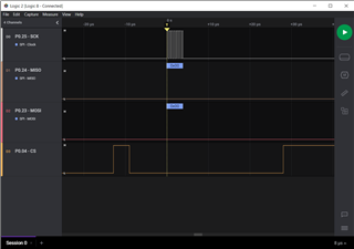

  • I see the following:
    Device ADS1291 is not ready
    [00:00:00.000,427] [1;31m<err> ADS1291: Failed to read id. Expected 0x2A got 0x0[0m
    The first log line is generated by
    const struct device *afe_dev = DEVICE_DT_GET_ANY(ti_ads1291);
    if (!device_is_ready(afe_dev)) {
    	printk("Device %s is not ready\n", afe_dev->name);
    The second log line is generated by:
    static int ads1291_init(const struct device *dev)
        struct ads1291_data *data = dev->data;
        const struct ads1291_dev_config *cfg = dev->config;
        int ret;
        data->bus = device_get_binding(cfg->spi_port);
        if (!data->bus) {
            LOG_ERR("SPI device not found: %s", cfg->spi_port);
            return -EINVAL;
    This code uses the following SPI config in the config struct which I copied from the ADXL372 example:
    static const struct ads1291_dev_config ads1291_config = {
        .spi_port = DT_INST_BUS_LABEL(0),
        .spi_slave = DT_INST_REG_ADDR(0),
        .spi_max_frequency = DT_INST_PROP(0, spi_max_frequency),
    #if DT_INST_SPI_DEV_HAS_CS_GPIOS(0)
        .gpio_cs_port = DT_INST_SPI_DEV_CS_GPIOS_LABEL(0),
        .cs_gpio = DT_INST_SPI_DEV_CS_GPIOS_PIN(0),
        .cs_flags = DT_INST_SPI_DEV_CS_GPIOS_FLAGS(0),

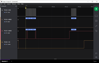

    I've had a second look with the logic analyser and it does seem to do something, but I also expect to see MOSI data. It does seem to recognize the 'spi-max-frequency = 2 MHz' which I set in the device tree under the sensor.
    For example, this is how the ADXL372 example looks with the same pin configuration as my project:

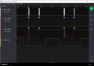

  • Sorry, I didn't look close enough at the messages. You're right the second message is generated by a different bit of code.
    Upon closer inspection it seems my spi code was doing something funky. I've now fixed it and it does write data:
    [00:00:00.000,366] [0m<dbg> ADS1291.ads1291_bus_access: REG Read for register 0x00 resulting in 0x20 sent[0m
    [00:00:00.000,366] [0m<dbg> ADS1291.ads1291_bus_access: Number of registers to read/write 2[0m
    [00:00:00.000,457] [1;31m<err> ADS1291: Failed to read id. Expected 0x2A got 0x00[0m
    The error message which started this post still remains but at least I can now continue development.
