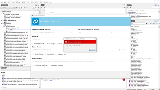

Hi
Actually this is my problem. I want to &led4 node to my device tree via overlay file.
