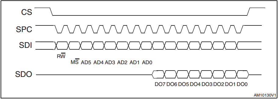

Added : Timing diagram of L3GD20.
SPI
-Regards, Mango922

    Suppose I attached a 3-axis digital gyroscope (L3GD20 for example) to the PCA10001.
    Using SPI, with the clock speed of 10 MHz, reading a value will take 1.6 * 10^-8 sec.
    (Since it uses 16 cycles.) After reading it, it need extra calculation to use it.
    However, since the nRF51822 does not have FPU (Floating Point Unit),
    I expected that the calculating time will be longer than 1.6 * 10^-8 sec.
    As you said, multiply will take much longer and if the program uses floating points, I thought it will take more.
    So, in this case, won't there be a slight delay to earn the value?
