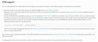

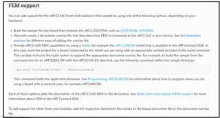

    4. Then, at documentation page for bluetooth sample, There was a topic "FEM Support". It seems developer shall
        set up the project to work 21540. Was it? I didn't do it since I have no idea how to follow the steps. Didn't you
        said 21540 DK board can work  fine only if we chose nrf21540_nrf52840 as board?
    Yes, if you build the project for nrf21540_nrf52840 then FEM support should be enable by default. Not sure why you are getting weaker signal on the nRF21540DK.
